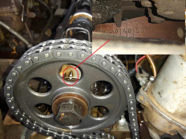

Hi Andrey,
for some of the old MB engines you will find complete kits including new timing chain and all parts, but I don't now if also for the M180. But as this motor is not only used on the unimog 404 the chance is good if you look on normal cars spare parts.
If you lost the slider now don't let the motor run as now the timing chain can skip by some chain links. In that case you ruin the motor
#575659
Thanx Jurgen,
The work slow down this weekend (I was in Greece for weekend). Tonight I was able to remove little 4 screw bolts bracket over valve cover. But the question stays:
I which direction should I try to remove the cover....thru front of engine or inside to the cabin?
Thanx for help!
