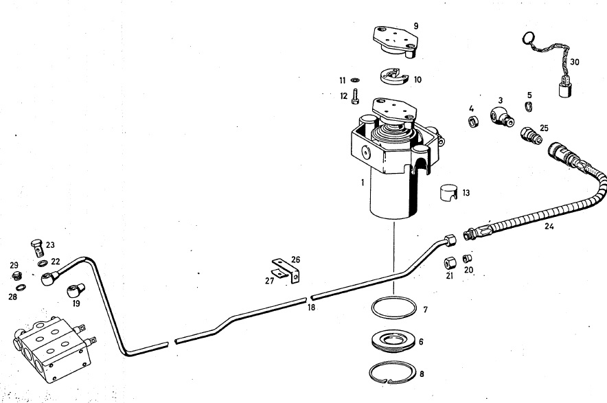

#529810
This picture shows the original platform in use with the 3 way tipper. Is the upper or tipping platform available anywhere? Are any of the parts to do this conversion available?
Dieses Bild zeigt die ursprüngliche Plattform, die mit dem 3-Wege-Kipper verwendet wird. Ist die obere oder kippbare Plattform irgendwo verfügbar? Ist einer der Teile für diese Konvertierung verfügbar?

#529821
Not for the Meiler parts. I don't know anyone owning this special equipment.
For latches: I asume you mean the three walls of the tipping platform. The hinges are remanufactured by Feulner Metallbau (both versions, old model and new 421 style models). The latch lock parts are standard farming machine parts. The wood can be remanufactured from plain planks and the steel U-profile around is of the shelf.
For the air piston only used parts are availabel.
For the hydraulic piston (a new spider frame is required) can be received from H.P. Holster. Platforms of the new style as well. Old air tipping platfroms are only available as used parts.
It makes absolutely no sense to focus on all variants. Let us know which type is in your focus and we can see, how we can support you. Otherwise you must search for parts by your self.
Regards,
Markus
#529822
hydraulic cylinder and platform until year ca. 1968.
#529823
If you need a pump, tank, control valve, cylinder, spider and platform, you are at min 3000 Euro without freight. Better to buy another Unimog for spares.
